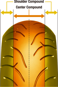

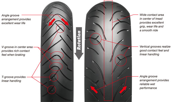

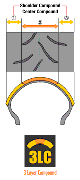

Bridgestone BT023
3LC (3 Layer Compound)
(appropriate compound placed in center and shoulder area)
Special Pattern for Front
Center compound :
results in good stability and wear life.
Shoulder compound :
provides grip and bump absorption.
New Pattern
BT023 New Pattern

No creo que haya ningún neumático para motos medianas grandes de 1 solo compuesto.
