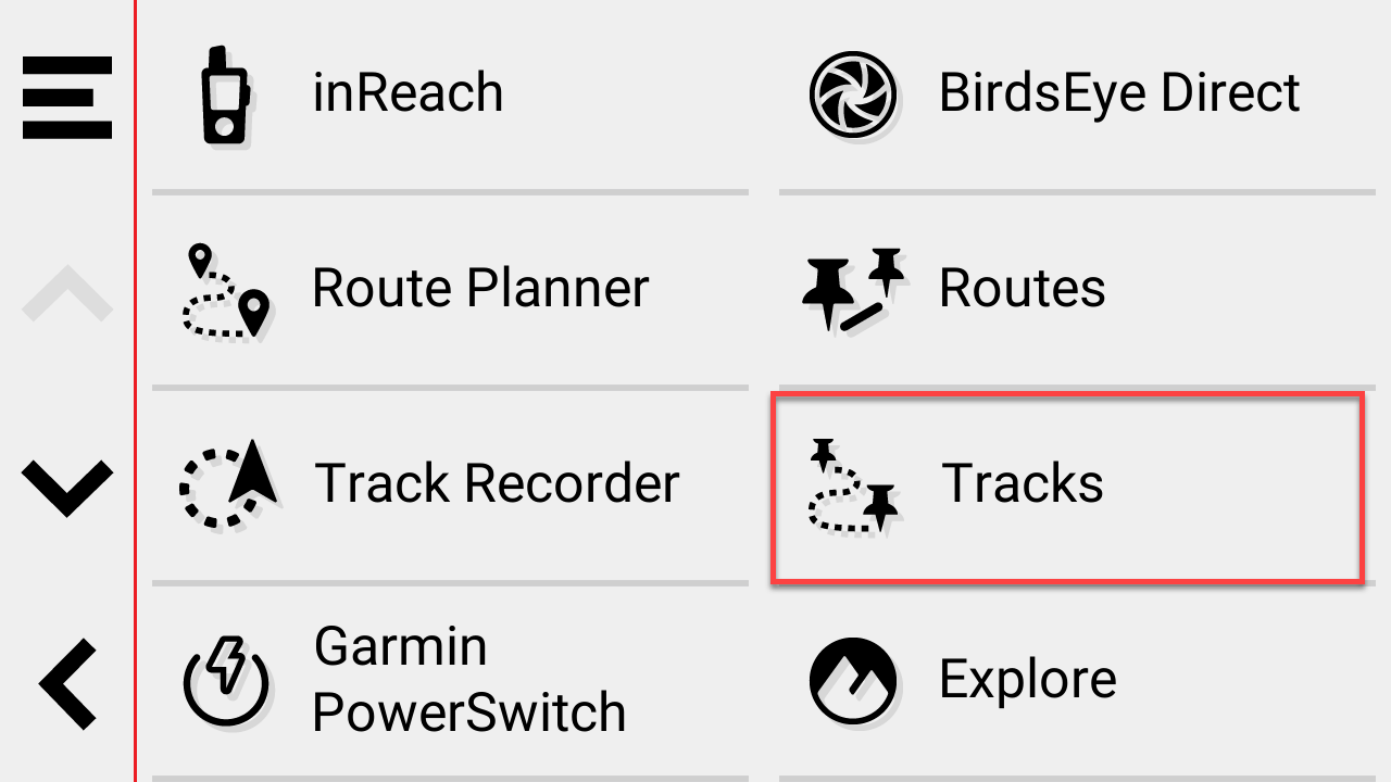

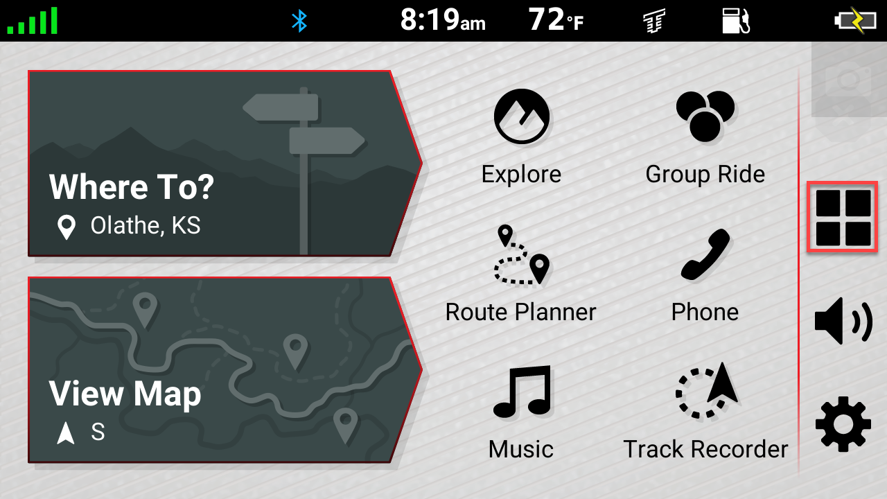

1. Select Apps
2. Select Tracks

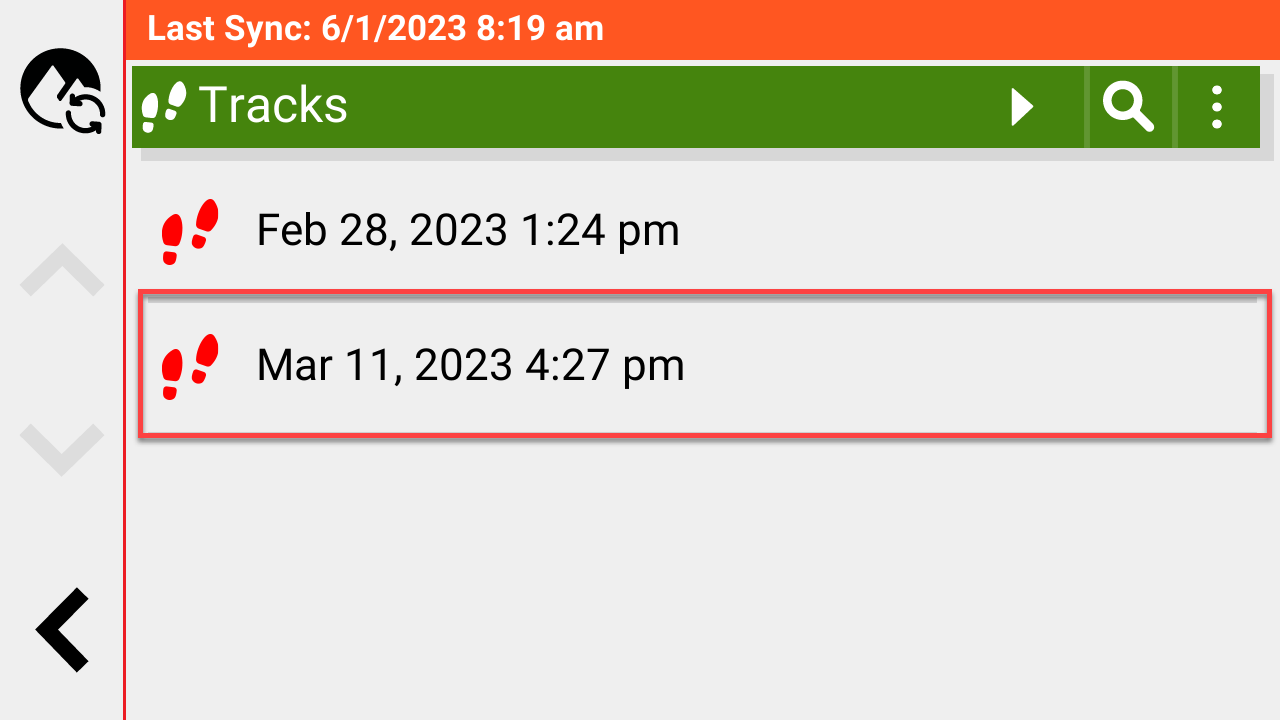

3. Select a Saved Track

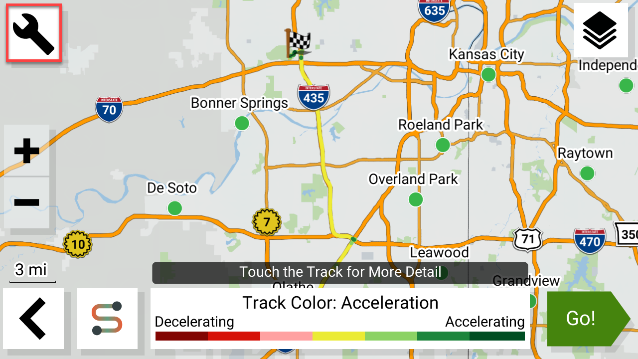

4. Select the wrench icon

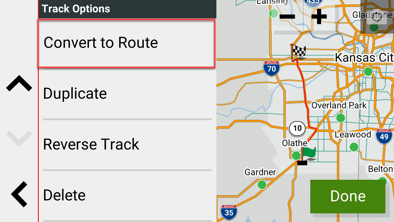

5. Touch Convert to Route

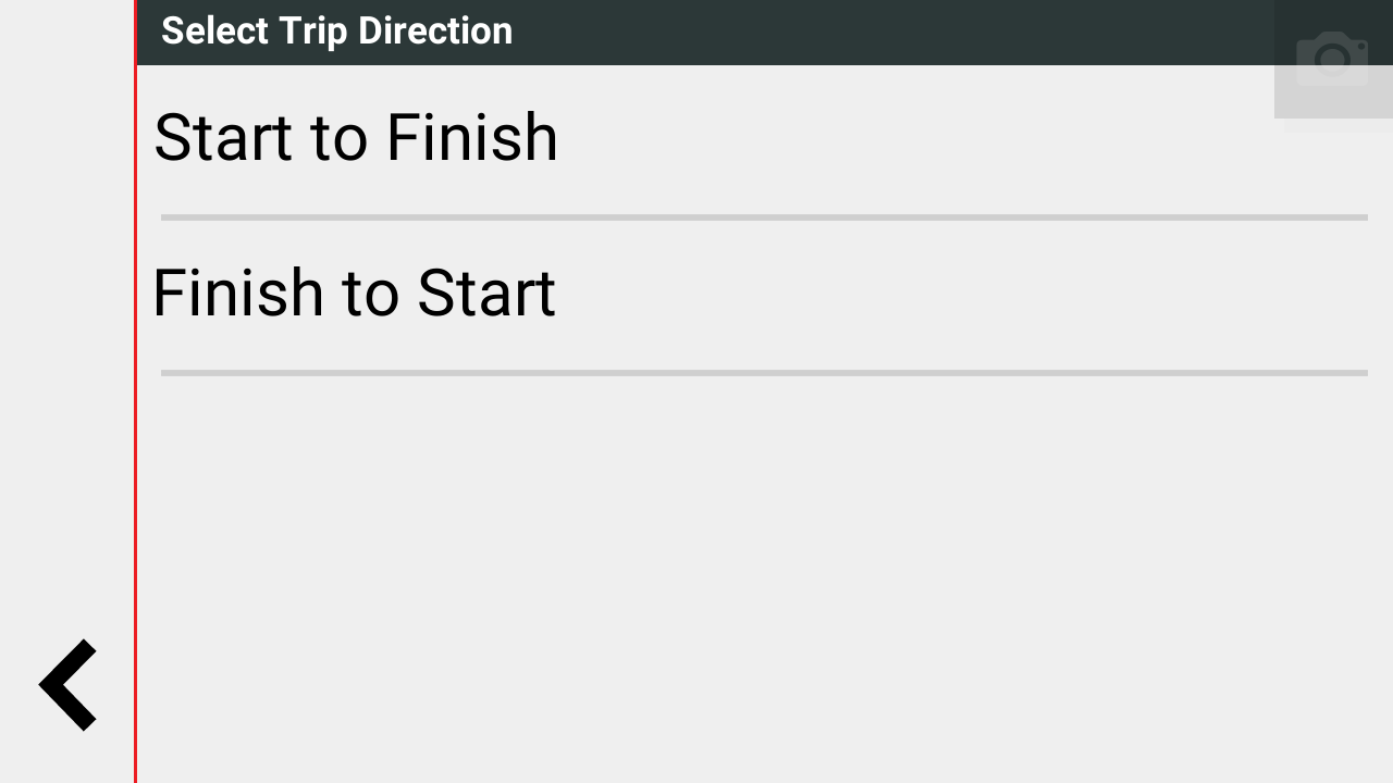

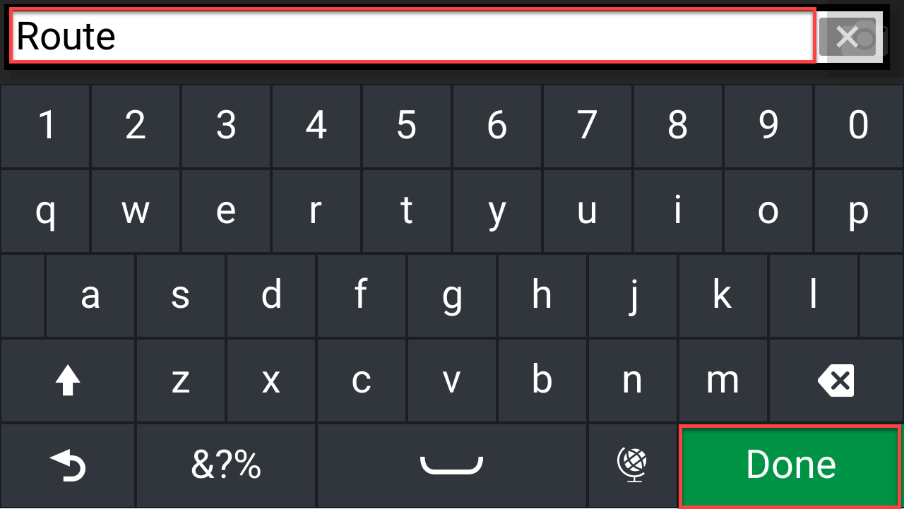

6. Touch the preferred route direction
7. Name the route and touch Done
The track log will now appear in the Explore library as a route. To share the route, proceed to the following steps.
