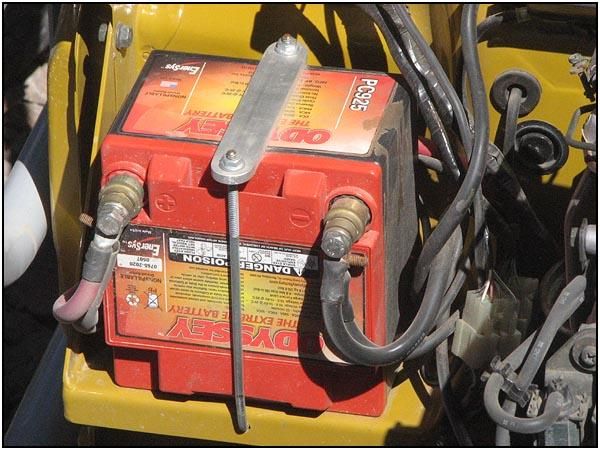

Por lo que veo en Google Image, es bastante comun montar la Odyssey PC925 "girada":
Si en la K100 interesa que el positivo quede a la derecha, no hay mas que girarla 180 grados (y de estas formas se leerian las letras "directamente") y ya tenemos el positivo a la derecha, aunque un poco bajo. Habria que ver si eso es un problema.

He encontrado en el estupendo foro yanki k11.org la foto de una K75 con una PC925. Supongo que el hueco es el mismo que en una K100:
If you have a 93 or earlier that takes a larger battery then there's an Odyssey that's bigger than the PC680 that will fit.
On the K75 I just bought the previous owner realized the battery was getting old and didn't want to send me out to ride back to Seattle with a battery that might not make it. He happens to be a battery distributor as a sideline and although he didn't have a PC680 on hand he did have a brand new PC925. The terminals are on opposite side and point forward, not up but other than that if fits pretty well.
