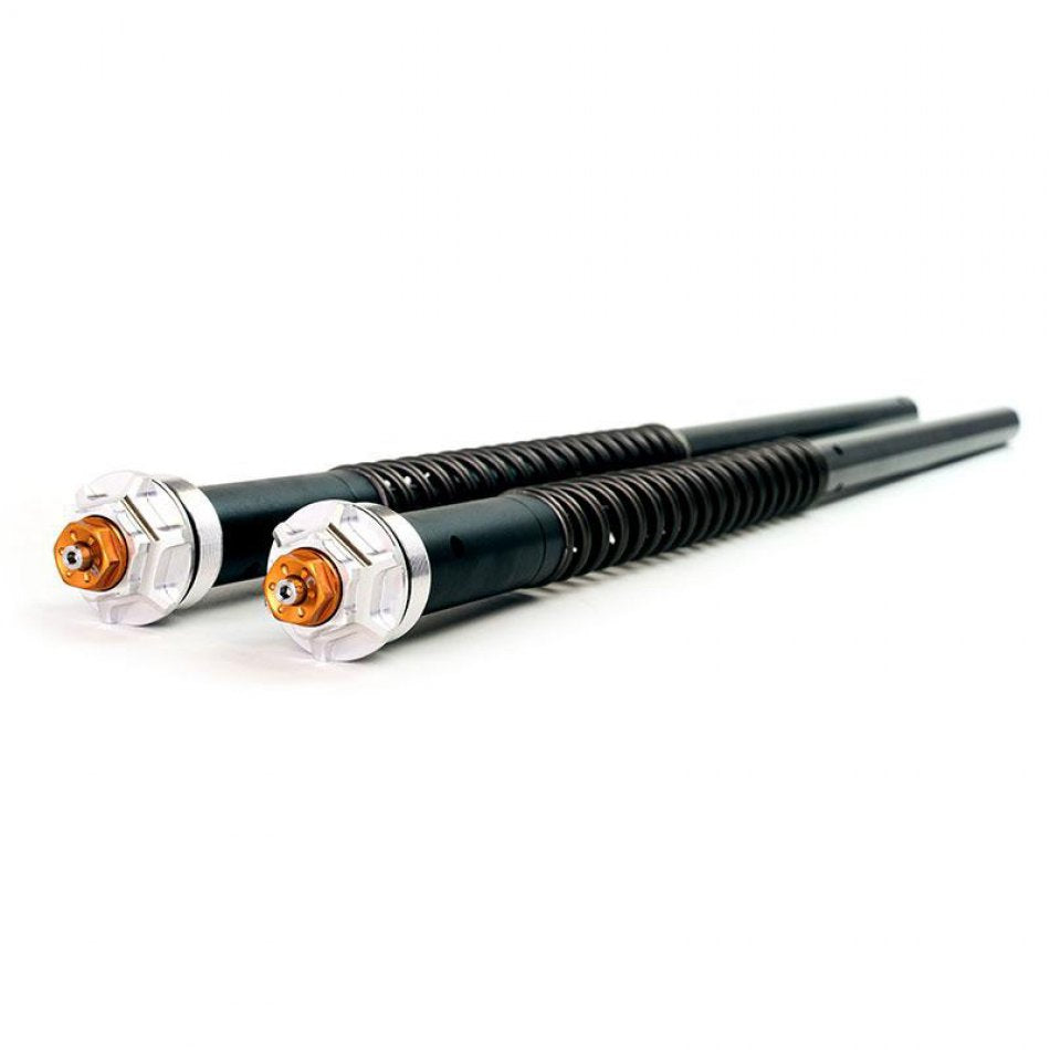

Fork Cartridge BMW K1 K100-16V K1100 NEW
Pair of fork cartridges for K models model 105_W06 (cap with thread)The K models have been built for many years, and BMW has used different suppliers and different fork designs.How to recognize your motorcycle's cartridge:105-W06, cap with thread, cartridge foot screw m10x1.5, fork length...kpartsholland.com
