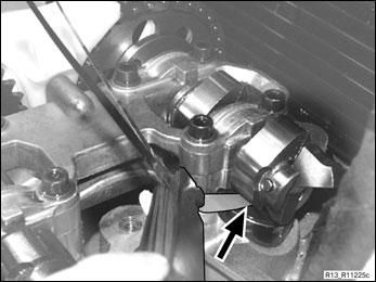

This has been bantered around on other threads and it applies to all bikes with the (2009+) Chinese-made single cylinder engine produced prior to mid-June 2012 (engines numbered before 61712400). Supposedly, problems are occurring with 1 out of 30 of such models.
It refers to a situation where your bike is running fine, you make a short stop and then have trouble starting it. The bike will not fire-off quickly as normal but lets the starter grind on and on. The battery is so small that not many grinds will run the battery down and you're dead in the water.
Often, in this situation, even after the battery has worn-down, if you let it sit for about 15 mins, the engine will cool-down and the battery will recover enough to pop the bike back to life as normal.
Many affected riders simply think their battery is getting weak and they replace the battery. A new, hot battery will overcome the Hot Start issue for a while but eventually the symptoms return.
The problem is the "decompression lever" attached to the end of the exhaust cam. This item is designed to fall into place and hold an exhaust valve open slightly during the initial start procedure. This relieves cylinder pressure enough to give the poor little starter motor and tiny battery enough of a chance to spin the motor quickly enough to start the motor.
In some situations, the decompression lever is not opening the exhaust valve enough to provide enough decompression relief. The motor won't spin fast enough to start.
The problem is caused by either of two things. The the valve lash clearance of the affected exhaust valve is too great and thus the decompression lever does not get enough push on the valve to open it sufficiently. Also, temperature variations in the related componentry vary the expansion and size of the related parts to a degree that adds to this issue of not allowing enough opening of the decompression exhaust valve.
The fix-
A new decompression lever has been offered by BMW,
part 11 31 8 540 965 (about $50)
that replaces the original lever. Also, checking the valve lash clearances is recommended to make sure there is not too much slop in the valve train.
BMW issued a service bulletin on this in 2012 and it is covered by any current warranty. They agreed to cover this problem for bikes out of warranty until December 31, 2013. If you are outside that category, discuss this pre-existing, known-condition with your dealer.
https://www.dropbox.com/s/5ubnydbxjy2yl7e/hotstart.pdf
The decompression lever is part number 2 in this illustration-
An actual photo of the cam assembly shows the decompression lever pivoting on the end of the cam.
The decompression lever is weighted and falls into position to add an additional bump on the valve bucket. Once the cam starts sipping centrifugal force causes the decompression lever to swing out of position and allow the lobe on the cam to be the only force on the valve bucket.

Aprovechando que en otro hilo se habla del click, subo unas fotos del cilindro derecho abierto. Ayer, estaba aburrido, y ante la falta de respuesta y curiosidad, le quite la tapa para tirar unas fotos y ver el "gatillo" si estaba duro o que. Y resulta que iba flojisimo. Parece mentira que a mas de 1000 rpm aun no se supere el threshold. Os subo unas fotos con algo mejor de detalle que las que se ven en inet:
Subido en subir imagenes
El jefe de taller de mi concesionario, me dijo que ese no es el ruido del descompresor, es un ruido endémico del motor, que no afecta para nada a su fiabilidad y rendimiento.
Delante de mí hizo saltar el descompresor acionando el freno a la vez que soltaba embrage en primera. Forzando de esta manera suena un clank, clanck, mucho más fuerte que el que oimos en nuestras motos al ralentí, y según él ése es el descompresor.
Por lo tanto creo que es mejor que nos acostumbremos (yo ya lo hice hace tiempo) e intentemos disfrutar de todo lo bueno que tiene la moto, que es muchísimo.
Seguramente en próximas versiones del motor, ese ruido no se oirá, pero creo que los nuestros se quedan como están.

Muchas gracias, Jussepe:thumbsup:. Ahora "ya le podemos poner cara al delincuente". No sé si, como se ha comentado más atrás, el aceite tendrá algo que ver en el asunto; pero, leyendo lo floja que dices que va, lo mismo sí que podría influir. Yo ya llevo un tiempo pensando que, viviendo en España (más en mi caso, totalmente al sur), el aceite que mejor se adaptaría a nuestra moto sería algún 50, como el 15w50, o mejor el 10w50, que también es 100% sintético, como el 5w40 que llevan. Según lo que leo en la red, la elección del rango del grado del aceite ha de hacerse en base a la temperatura ambiente donde vaya a usarse la moto y, obviamente, no es lo mismo estar en Alemania, que en Suecia, que en España. El tener los que terminan en 50 una viscosidad mayor en caliente, debe venir bien a nuestros motores que cuando se calienta, en lugar de ir mejor, van peor. Cuando me toque la revisión de los 10.000 kms, lo voy a comentar con el concesionario para ver si no hay pega en probarlo. De hecho, no es que Bmw imponga el 5w40, sino que es el que recomienda. Y las especificaciones técnicas del 10w50 no son inferiores, sino adecuadas para temperaturas superiores, según deduzco.
